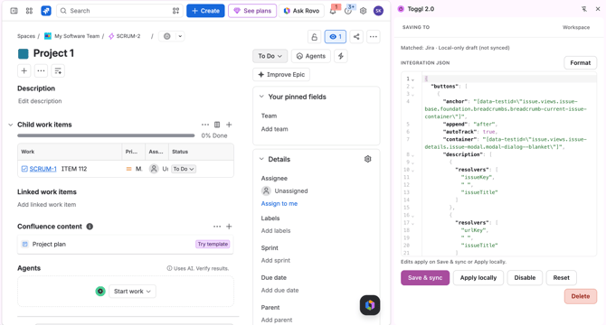

Option B — the JSON editor
Right-click the Toggl toolbar icon → Open side panel. It opens with the definition for whatever site you are on, already filled in.
json-editor
The buttons:
  • Save & sync — saves to your organisation. Everyone in the org gets it.
  • Apply locally — try it on your machine only. Survives a page refresh, syncs nowhere. Use this while experimenting.
  • Disable — stop the button appearing on this site. Your changes are kept.
  • Reset — throw away your edits.
  • Delete — remove your organisation's version. A built-in one comes back if the site has one.
💡 Editing one of our built-in integrations does not change the built-in. The moment you save, your version is stored as a custom integration owned by your organisation, and it takes over for that site. Delete it and the original comes back.
It is stored as the difference from the built-in, so fixes we ship to the built-in still reach you. If the panel warns that it has to save a full copy (usually because the built-in buttons were reordered), they will not.
The editor checks your JSON as you type and refuses to save something malformed, so you cannot break an integration by mistyping.

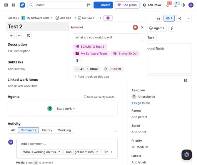

field:value tags
The pattern people ask for most: a tag that carries a label and a value, like Status:To Do, Priority:Urgent or Language:english. It makes tags readable in reports instead of a soup of bare words.
🚨 The obvious way does not work, and fails silently. Writing ["Status:", "status"] produces two separate tags — Status: and To Do — because the tags field splits every part into its own tag. Adding join does not help; it is ignored for tags.
Build the label into the value with regex and replace instead.
The form that works, on a Jira issue:
"statusTag": {
  "root": true,
  "query": "[data-testid='issue-field-status.ui.status-view.status-button.status-button--text']",
  "regex": "^(.*)$",
  "replace": "Status:$1"
hen name it in the button: "tags": ["statusTag"]
Read "replace" as "whatever the regex captured, put it after Status:". $1 is the captured part. If the regex matches nothing, you simply get no tag — never a broken one.

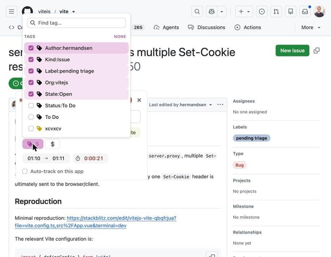

Worked example — GitHub
One click on a GitHub issue, mapped to seven values from two different sources: the page itself and the URL.
github-tags
Field Source Result
Project URL path vitejs/vite
Tag Page — repeats per label Label:pending triage
Tag Page State:Open
Tag Page Author:hermandsen
Tag URL path Org:vitejs
Tag URL path Kind:Issue
The resolvers behind it
"repoProject": { "url": "path", "regex": "^/([^/]+/[^/]+)", "replace": "$1" },
"labelTag":    { "closest": "@issue-viewer", "query": "div[data-testid='issue-labels'] span[class^='prc-Text-Text']", "regex": "^(.*)$", "replace": "Label:$1" },
"stateTag":    { "closest": "@issue-viewer", "query": "[data-testid='header-state']", "regex": "^(.*)$", "replace": "State:$1" },
"authorTag":   { "closest": "@issue-viewer", "query": "[data-testid='issue-body-header-author']", "regex": "^(.*)$", "replace": "Author:$1" },
"orgTag":      { "url": "path", "regex": "^/([^/]+)/", "replace": "Org:$1" },
"kindTag":     { "url": "path", "regex": "/issues/", "replace": "Kind:Issue" }
On the button: "project": ["repoProject"] and "tags": ["labelTag", "stateTag", "authorTag", "orgTag", "kindTag"]
Why the project-from-URL trick matters: time spent on any issue in a repository now rolls up to that repository automatically. Nobody has to create the project or remember to pick it.

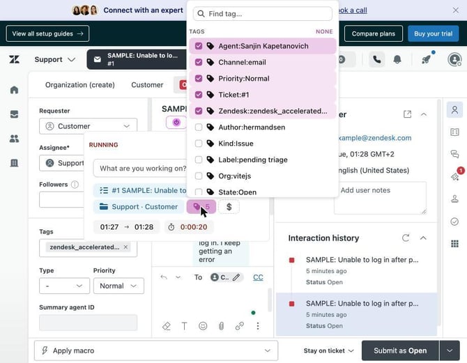

Worked example — Zendesk
The same idea aimed at support, where the useful grouping is the customer rather than the repository.
zendesk-tags
Field Source Result
Project Requester field Support · Customer
Tag Priority field Priority:Normal
Tag Assignee, group prefix stripped Agent:Sanjin Kapetanovich
Tag Via label, word "Via" stripped Channel:email
Tag Zendesk's own ticket tags Zendesk:zendesk_accelerated_setup
Tag An HTML attribute, not visible text Ticket:#1
Every minute rolls up per customer on its own, then splits by priority, channel and agent. That is a billing report that configures itself.

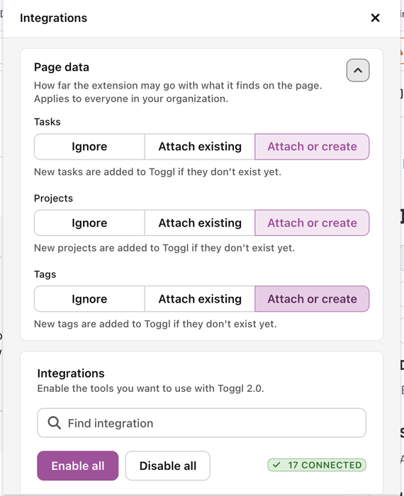

The Page data controls
All of the above depends on what the extension is allowed to do with the names it reads off the page. That is set once for the whole organisation, at the top of the Integrations screen, with a separate setting for tasks, projects and tags.
page-data-controls
Each of the three has the same options:
Option What happens
Attach or create The default. The extension matches what already exists in Toggl, and creates whatever is missing.
Attach existing The extension only matches what already exists. Nothing new is created; a value with no match is skipped.
Ignore The extension does not use the page value at all, even when it already exists in Toggl. With tasks on Ignore, every entry is titled with the page text instead, so it stays identifiable. With projects on Ignore, a task that is matched still keeps its own project.
They are independent. An org can let tasks be created but only ever match existing projects, or ignore tags entirely while still filing everything under the right project. Whatever you pick, a start still records time. Worst case it arrives without that piece attached.
Only organisation admins can change these. If your carefully built mapping produces nothing, check them first.

Two tags where you wanted one field:value tag Literal parts under tags; use regex • replace instead

Project chip empty but tags fine Projects set to Ignore in the Page data controls, or the name does not match exactly — check capitalisation and stray whitespace
